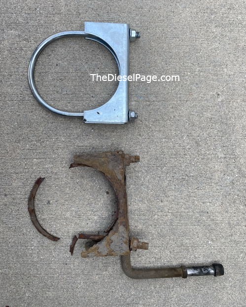

    I replaced the factory exhaust system in my 2001 GMC back in 2007 with an aftermarket 4" performance-oriented exhaust system. Most of this system is made using stainless-steel, which remains in fine shape despite the intervening years of winter road de-icer. However, there was one exhaust system hanger not made from stainless that wasn't quite up to the challenge.
    The angled rod shown here (attached to the rusty clamp) was made from stainless-steel. The rod had accumulated a thin layer of crud, but it was not corroded or had deteriorated in any other way. This angled rod was removed from the rusty clamp using a cut-off wheel a few minutes after this photo was taken, then cleaned and welded onto the new clamp shown at the top of this photo. The new clamp is made from stainless and galvanized steel. By the way, this particular clamp is used at the rear of the muffler. Surprisingly, this was the only badly rusted exhaust system clamp. All of the other clamps were OK, apparently made from either stainless or galvanized steel.
    It's all good now! No worries. I'm not mentioning the brand of exhaust system for a couple of reasons... 1- This system has been on the truck for 15 years. 2- Products change over time. So, if you're in the market for a performance exhaust system, ask about its resistance to the highly corrosive nature of road de-icer. Do they use stainless-steel or other corrosion-resistant materials?
