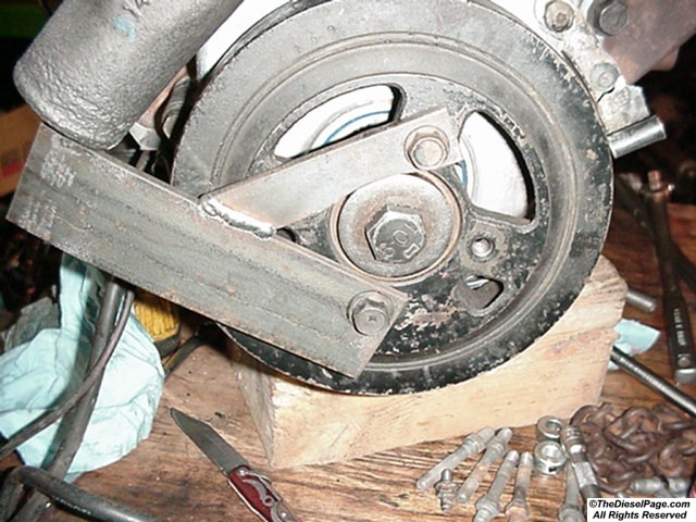

    Arrow Damper Bolt Tightening Fixture
    Here's a photo showing what member M.J. McCarroll uses when torquing the damper bolt to the recommended 200 ft-lbs.
    The damper bolt can be removed using an air wrench, but this fixture allows easy bolt torquing if you're working by yourself.
    Thanks M.J. for sharing!
    Jim

    Definately a good little device.
    I usually use the 1/2" impact and zap the bolt good with a little blue loctite on the threads.

    Oh, Robyn knows a good deal about these rattle box engines, but the Impact idea is a very bad one. Make a fixture or use my 1/2" extension wedged in a strategic area to lock it down and tighten that guy to the required 200 ft. lbs.
